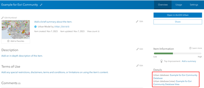

DominikAllemann
Hi @ScottEdmondson ,
We are aware that deleting an urban model is currently missing. The feature will be added with a future release.
Happy to hear that you figured out the workaround to delete an urban model.
Just a clarifying remark to ensure that you don't keep unnecessary items in your ArcGIS Online (AGO) account:
  • An urban model consists of 3 AGO items in total:
    • An Urban Model item
    • A feature layer (named after the urban model suffixed with "Database")
    • A feature layer view (named after the urban model suffixed with "Database View")
  • You need to delete all three items to remove your urban model completely.
  • On the details page of the Urban Model item there are links to the associated feature layer and feature layer view items. This makes it easier to identify all items associated with the urban model itself.
Please reach out in case of additional questions.
