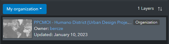

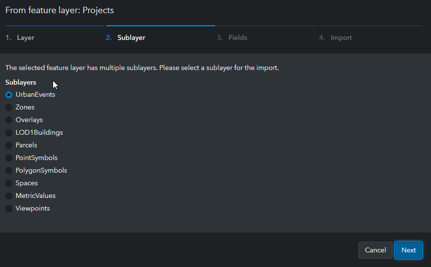

I tryed the Add from feature layer from the model configuration menu, selecting a UrbanDesignDatabases and the UrbanEvents layer.
Howerver, the scenarios and the project design context were not cloned.
