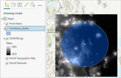

I also assume you are looking to map a circular area, since you mentioned a radius. You first need a polygon layer representing this area. Here's how you can make one:
1. Insert Point Map Notes.
2. On the ribbon, on the Edit tab, click Create. Use the Create Features pane to draw one point in the middle of the area you want to map.
3. Save your edits. Clear the selection.

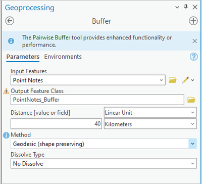

4. Open the Buffer geoprocessing tool. For Input Features, choose the Point Notes layer. For Distance, specify the radius you desire.
You now have a polygon representing your mapping area.
Next, you need to clip the elevation layer to the circle:

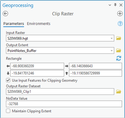

5. Open the Clip Raster geoprocessing tool. For Input Raster, choose the DEM. For Output Extent, choose your the new polygon layer. Check Use Input Features for Clipping Geometry.
Another new layer is added to your map. Turn off the other layers. You now have a circular DEM.

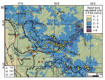

Thank you @HeatherSmith for taking time for this elaborate guide. However, this does not solve the problem yet. In my case, I wish to quantitatively estimate the relief (local relief =maximum elevation- minimum elevation, over a given distance for a specific region). Indeed, this statement provides the mathematical approach to achieving the outcome but I do know how to manipulate either ArcGIS or others to achieve this. Please could you take a close look at the attached Figure? Fig.5a.JPG
The authors obtained the local relief by measuring the difference between minimum and maximum elevation within 10 km diameter (5km radius) windows around each pixel in the DEM. (This image is the Figure 5A of Thiede et al. (2009) , titled Erosional variability along the northwest Himalaya).
Take note that along the river, relief is highest whereas in the traditional hillshade, the elevation value will be lowest along the river as you have obtained above.
Thank you for your time and hopefully, I get a solution to this.
