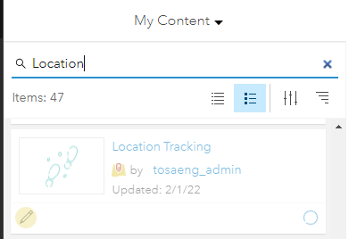

Hi @PaulVepraskas for the first case, do you have screenshot of it? Are you using ArcGIS Online or Enterprise?
PaulVepraskas
ArcGIS Online - below is the result... It just spins for ever and ever.

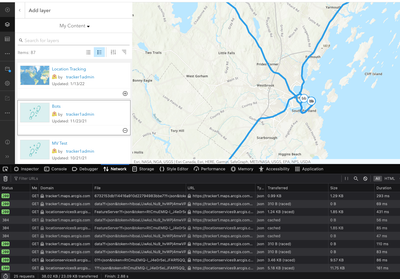

My guess is the requests to fetch the feature service definition are failing or timing out due to a backend issue. You could try opening developer tools in your browser, opening the network tab, and then clicking to add the item to the map. If everything works correctly, you should see successful requests. If it's not working these will return no data and not have a 200 response.
This is what it should look like:
If you consistently see this issue, I'd recommend opening a support ticket.
