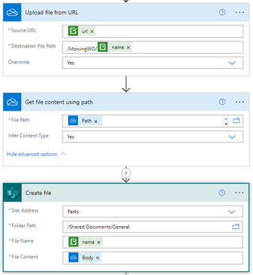

If you meant to include attachments to your reply it seems you forgot to attach them or they got lost in the ether. But it seems that the issue is somewhere in the Get file content or the Create file if it works fine when it's put into your OneDrive! It's odd that it only happens with multi-page reports though.
This screenshot shows these steps in my flow. However I don't currently have any reports that really go multiple pages (tables will make them multiple pages on occasion) and I much more often export my reports using the docx (Word Document) format as it allows changes to be made later in the work flow more easily.

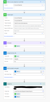

MariusVerdes
And, for more context, this is how my flow looks like:
Where the URL from the Upload file from URL (OneDrive) is the "URL of the first result file"
