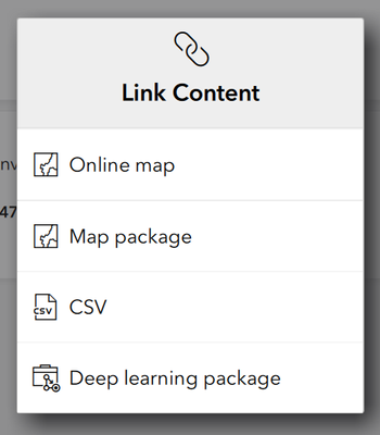

HollyTorpey_LSA
@Leena_Abdulqader Sorry for the slow response.
I'm trying to add the layer as linked content, but it appears that I can only add the following content types:
I tried adding the URL parameters (and a bunch of variations thereof) but no luck so far. I've also tried adding our organization to the domain (https://utility.<org>.arcgis.com). The pulldata expression returns nothing in both the mobile app and the form opened in a browser.
If you know how to add a layer as linked content, please let me know!
