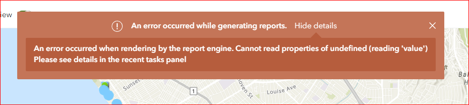

Hello, I have been working on a conditional report template for a Survey123 form. I have managed to eliminate all errors received so far, except for this last error.  Usually this error means something is up with quotation marks being the incorrect type. I went through my template and replaced all quote marks by copying and pasting from 'Quick Reference'. The form is a nested triple repeat so I figure this error may have something to do with the repeats. I can successfully upload the template, but when I attempt to run a test print, I get this error - unless the form I am printing only has one child, then it will print. When the report has multiple children, it fails. I really need some direction on how to capture the repeats in the report template. I have attached the template and the xls sheet.  Thank you for any assistance!

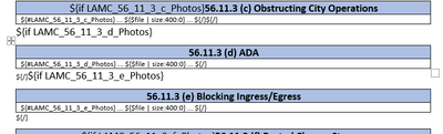

appearance:multiline needs to be on a new line. E.g., turn this...
into this...
Not a syntax issue, but it looks like you will run into blank space issues with all that dynamic content. If you swap your IF() statements from this...
to something like this...
You wont have as many blank spaces.
Didn't see anything else that jumped out at me. Again, a visual sweep isn't as good as actually testing, so there's a decent change I missed something.

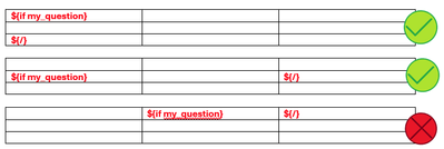

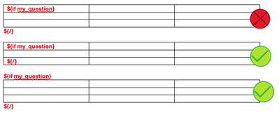

If you didn't already know this, I wanted to add on one thing about IF() statements in Feature Reports (this is mainly what I ended up looking for):
  1. An IF() statement must start and end either inside or outside a table. E.g., You cannot start the IF() statement inside a table and end it outside the table. This will result in an error.
  2. IF() statements within tables must start and end as the first and list things within the table or the table row
