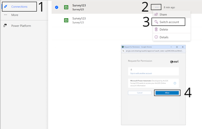

DrewMoffitt
Here's how I solve my Survey123 losing connection in PowerAutomate.
I have to go into my PowerAutomate account on occasion and perform the following steps.
1: Connections
2: Press the three dots on the Survey123 Connection
3: Press Switch account
4: Login to the account again

PaulCone2
I think the connection times out every two weeks or so, but the flow usually stays working.  If you want to edit it though you have to redo the connection.
