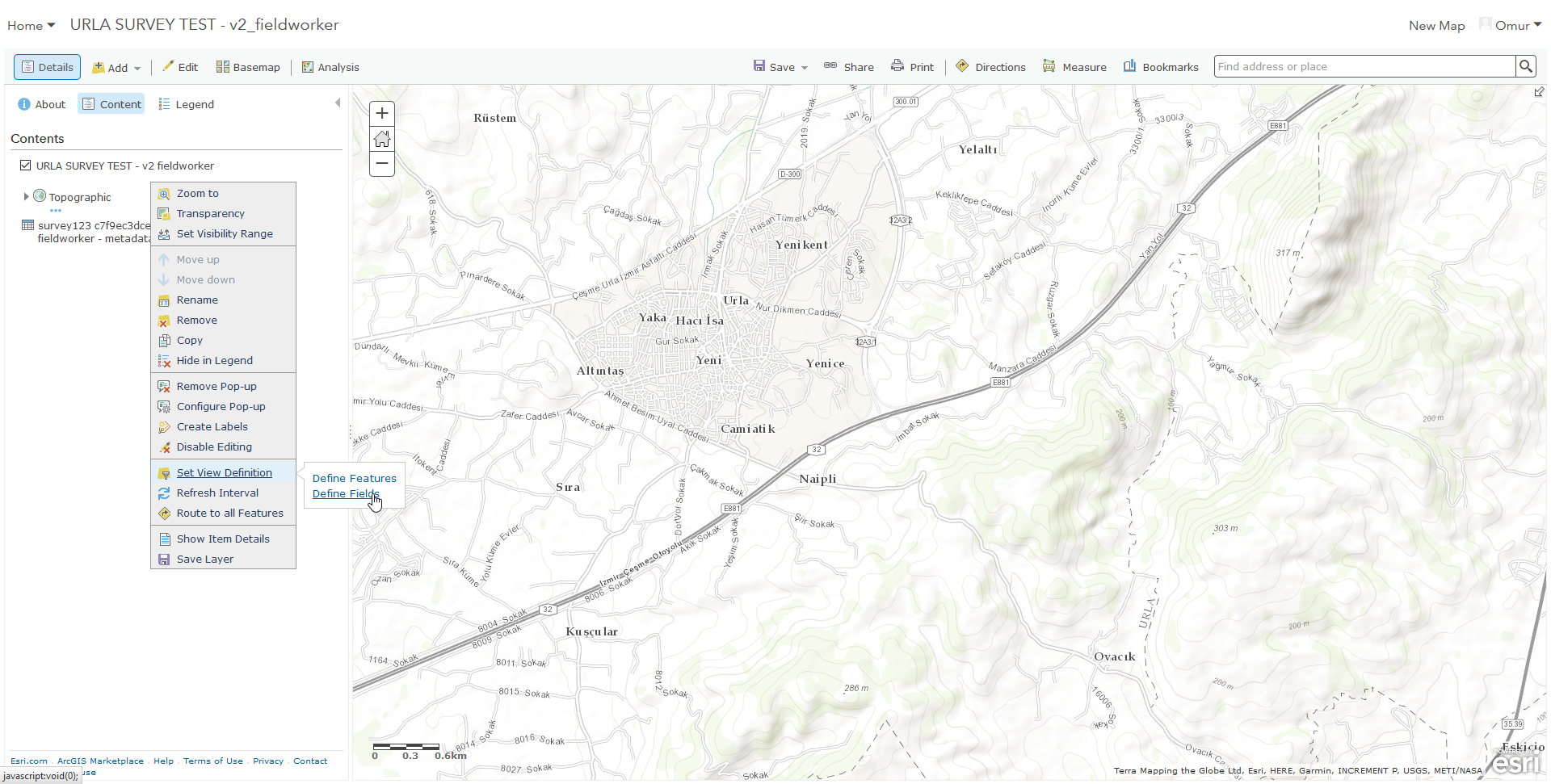

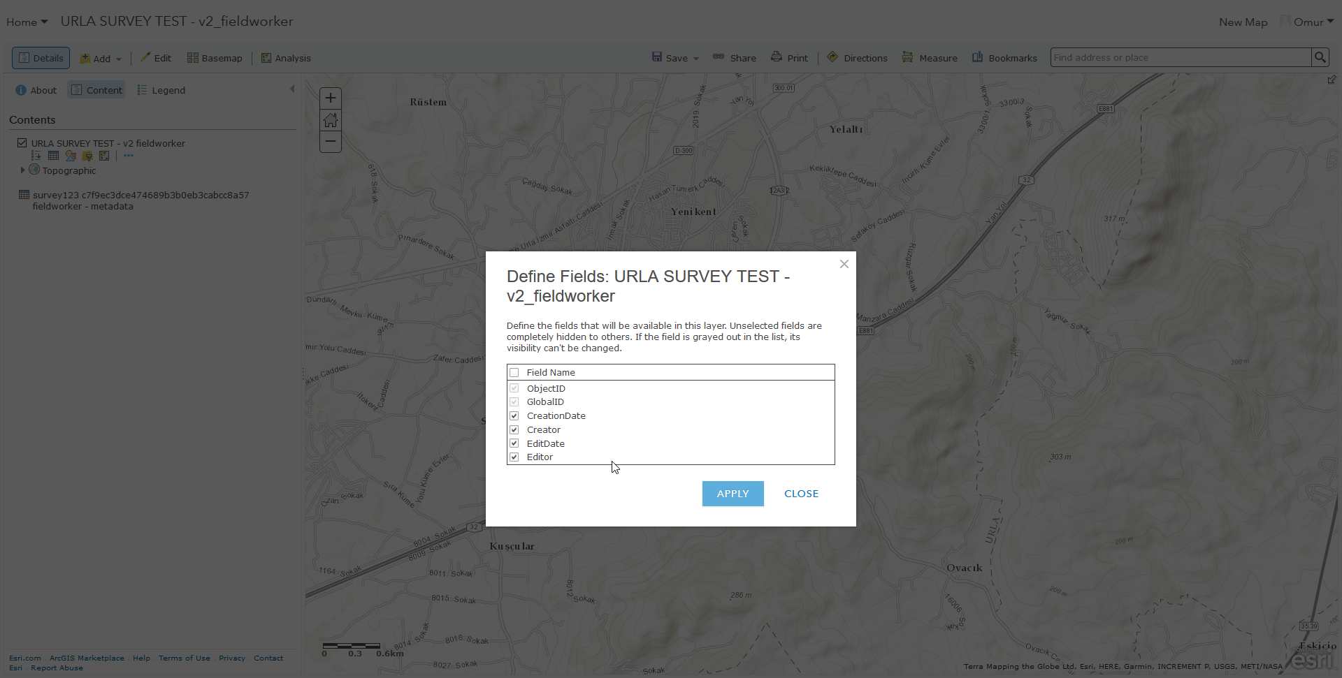

Hi James,
I followed the steps you suggested and asked one of my students to submit the form again.
The number of records increased after she submitted the forms again.Unfortunately, the table still looks empty. I attached screenshots showing each step. I'm not sure if I missed something but I'm still confused. I have a question at this point :
Would there be duplicated records for each student after they submit the forms ? If so, should  I delete all existing records to avoid any possible confusion ?
I'm willing to invite tech support people to our AGOL organizational account or moreover I can share my administrator account information to check the survey and any other related layers. The only downside is the survey form is not in English.
I would appreciate it if you could kindly let me know what you think.
Regards
Step 1
Step 2
