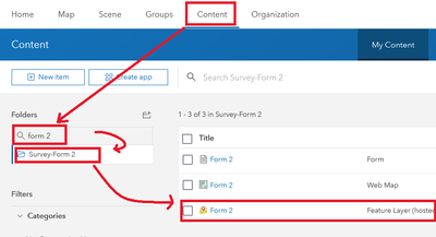

(1) Go to your Portal > Content > search for the survey name > click on the folder > go to the Feature Layer > Export Data > choose option

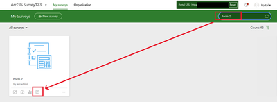

(2) Go to the S123 website > search for the survey > click on the Data button >  Export > choose option.
