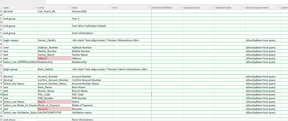

I found the solution need ot update the value of "allowUpdates=true query"  to all the repeat group questions in the "bind::esri:parameters" colunm in xls form.Screenshot 2024-07-28 145759.png

Yes, using query allowUpdates=true (order shouldn't matter - this is just the order I am used to) in that column will allow you to makes edits to repeats in the Inbox.
