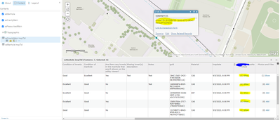

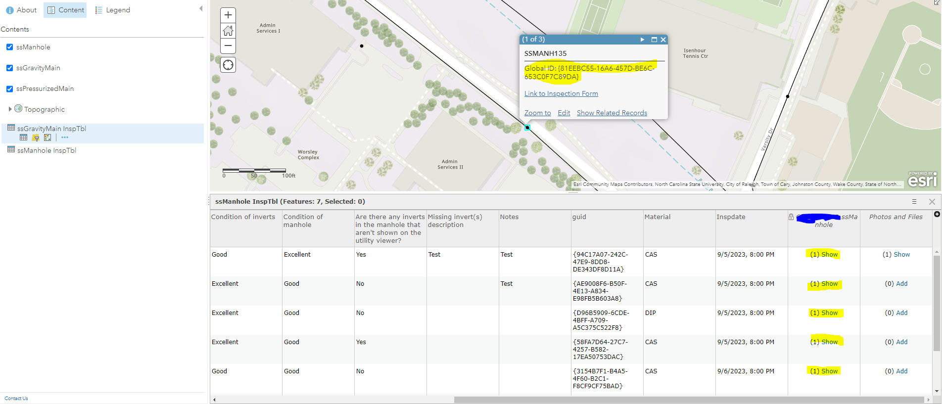

I'm having an issue viewing viewing related data. While it appears that the relationship is maintained between the feature class and inspection table, I can't see related records in either the web map or accessing the sde data in Pro. I also noticed that the values populated in the guid field for the inspection table don't match the corresponding feature's GlobalID. The examples below were all entered for this same manhole point.

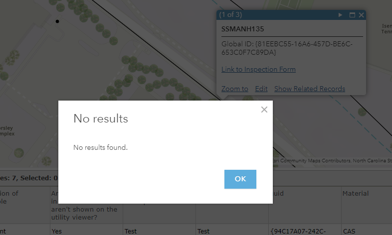

This is what happens when I select show related records in the webmap:
My understanding is that since the survey is built on a feature service with the relationship class, I don't have to pass the GlobalID value to the guid field - although, I tried this anyway (through the inspection url) and it didn't work. I assume this is because the guid field is within the repeat.

I use a lot of custom relationship classes but I also leave in the built in ones from 123.  I think that 123 will only automatically keep your related keys populated if you use the built in way with parentglobalid field in the child.  I will allow other relates to be in there but it is on you to keep them populated correctly.  That is why I use meaningful keys and not globalid so then I can calculate my child and parent keys easily and keep them in sync.  Plus if you ever export and import to something else like a GDB the globalid plan goes sideways.  123 team may know better if using a different relationship class is supported yet.
In your case I am actually not sure how to get the globalid of the parent inside the form.  If you have just the repeat in your form and not the parent (which I recommend) then you could pass the parent globalid over in a URL and give it to your key field in the child.
Field Maps will auto populate any child key it can find unless there are more than one relate I think it just does the first.  What we do is use Field Maps to navigate to the parent point then use a URL to launch 123 and add a child passing over the key.  That way we never have people editing and changing the parent.  I also always suggest to make the related inspection a feature class vs a table.  We have crews use the wrong parent on the regular and the map clearly shows they were somewhere else.
