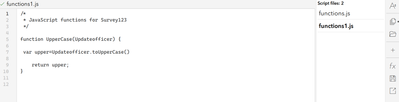

Thank you for this, the function seems to load fine but when I try to test the function in the Survey123 connect form (unpublished), nothing happens, and the text remains uncapitalised?
LMedeirosUI
@LAM123 Did you test it in the script testing area of S123 Connect?
If it works there, then you'll need another field to output the calculate results to. The calculate function won't update the field it used to obtain information, it needs somewhere to output it to. See attached screenshots, zipped script, and XLS form.
