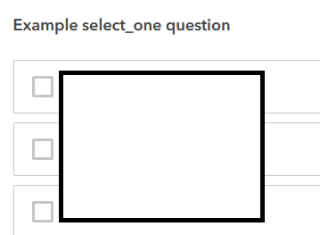

Here is an external select_multiple I did as a test. This CSV as ~1300 choices and it displays fine in web.
(name list, so names censored. I know this isn't a lot to go off of, but trust me when I say it's a working External Select in web!)

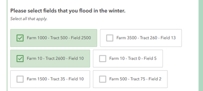

Missing fieldinfo.csv, which I believe is the main drop-down you were having issues with. Also missing producerinfo.csv, which is used to filter fieldinfo later on (I just removed that filter). I used a copy of idnumbers_media(1).csv for now. I also cleared the relevant column just to make testing easier. The list worked as expected (obviously the wrong list due to limitations above):
I would check the format of the CSVs, and replace that reserved name within the XLSX. Give it another try after that and hopefully it works.
