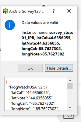

In my original post, I could not figure out how to get photos embedded but the image icon is showing up now. Included are screenshots from Survey123 connect.
Selecting stop in Survey123 connect correctly syncs with lat/long pointSelecting stop in Survey123 connect correctly syncs with lat/long point
pop up box after clicking check box in Survey123 Connectpop up box after clicking check box in Survey123 Connect
