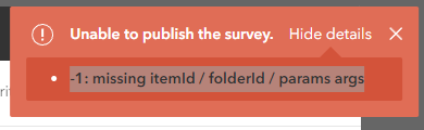

Unable to publish survey. Error "Unable to publish the survey. -1: missing itemId / folderId / Params args

I have a survey that I am attempting to update. The layer and associated views are a part of a collaboration from Online to Portal. I have made some changes to the form (removing previous employees' emails and adding my email to a dropdown). After saving and attempting to publish I get the following error.

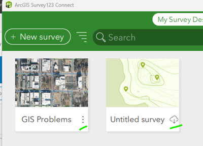

Then, in Connect, you should see this:
Press the download from cloud button. From there, you can edit and publish like normal.
Is that what you did?

In Connect I do not see this option mentioned above. It does show up on my test survey.

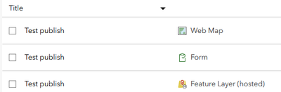

I created a survey to just see how it behaves. As I am sure you know (but I am limited in my experience) the survey created a Hosted feature layer, report view, and form view. No map.

The vertical ellipses means that survey is already local to your machine. If you manually delete the folder from your PC, it will swap back to the cloud image (assuming it is published - if it just disappears from Connect, it's unpublished). If you didn't already know, Connect saves (by default) to this location:

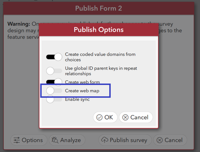

Web maps aren't technically required. But they are enabled by default. If you manually change this setting during initial publishing, there is no Web Map. After initial publishing, the only option is "web form".
If someone else published the survey, you wont have a folder in Your Content. I believe they end up in your root folder when you take ownership. I also wouldn't advise moving the files manually. That may lead to odd behaviours.
