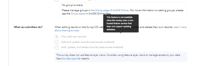

However, now that I'm testing it with my portal members who will be the ones updating the records, they are getting the error:  Editing is not possible because the record specified by the globalId parameter cannot be accessed.
The feature service is editable, the Portal members are Field Workers with edit capability. The dashboard is set up correctly to use the globalid of the survey. I don't understand why it's not working. It has to be a permissions error? My googling led me to believe I need to allow submitters to update records, but because this is a non-hosted feature service I'm getting an error that I can't.

I'm going to post my "solution" for anyone interested, which really isn't a solution but it's what I had to do. Hopefully the Survey123 team sees this and can investigate for future releases:
After being 100% certain that the feature service and survey were share correctly, I decided that something wonky happened in Survey123 that I wasn't going to be able to fix. For some reason, even though my feature service was editable by users in my organization, Survey123 was set to allow submitters to "Only add new records" instead of "Add, update, and delete records". This setting was greyed out in the Survey123 website because it is a non-hosted feature service, and Survey123 would not allow me to change it.
I deleted the survey completely and created a new one from scratch. This time, the setting was correctly set to "Add, update, and delete records". Now all users can edit all survey records.

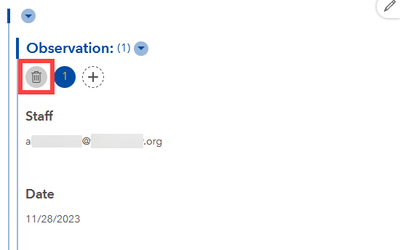

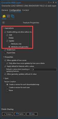

I also had the same issue as @ShelbyZelonisRoberson but see it's related to how I configure my feature service when publishing from pro.
Weirdly though, despite not allowing a user to delete I still get the trash can icon in my survey for relates/related table records. Hitting delete (and confirming) doesn't actually delete a record though. So how do I remove the trash can icon?

Hi @ahargreaves_FW ,
The UI of Survey123 allows a user to delete a repeat in the same session it is created (i.e., before submission); that is what the trash can icon is for.  It does not allow for the deletion of repeats that have already been submitted (i.e., during an editing process).
