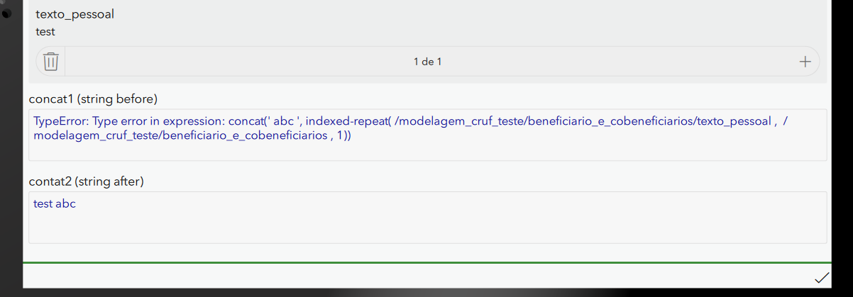

Hello everybody.
I'm trying to use the indexed-repeat function within the concat function, however, I've been receiving a "TypeError" whenever I concatenate some text before the indexed-repeat.
However, if I change the position of the same text after indexed-repeat, concat works normally.

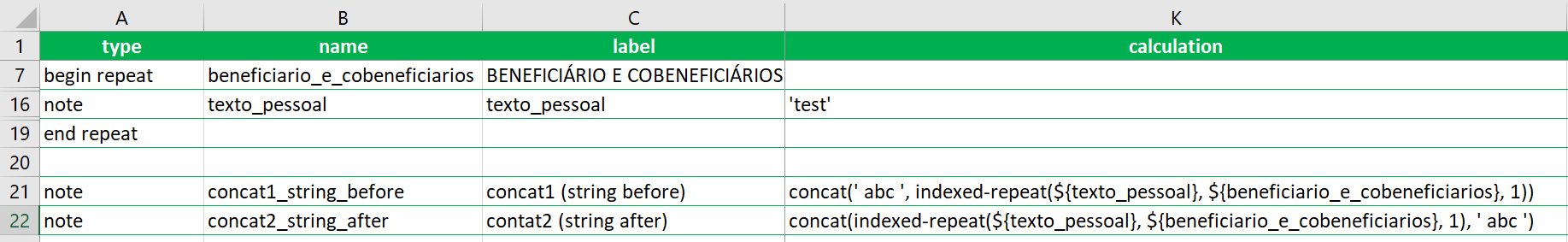

concat(' abc ', indexed-repeat(${texto_pessoal}, ${beneficiario_e_cobeneficiarios}, 1))
concat(indexed-repeat(${texto_pessoal}, ${beneficiario_e_cobeneficiarios}, 1), ' abc ')
I've already tried to force the conversion of parameters with the "string" function, I've already tried putting "str" in bind::type and nothing worked. Replacing "concat" with "+" works in simple expressions, however, in more complex expressions (using the "if" function) I continue to receive the same error.
I'm using Connect 3.19.104
Any explanation or solution for this error?
