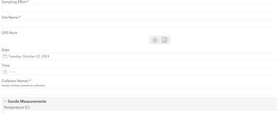

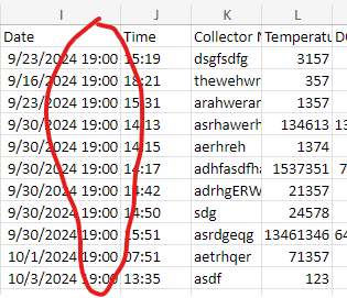

I have a survey with a date field, and every time i export the data, there is a time within the date column. Why is it doing this?

Arc databases only do date and time combined.  No way around it.  They did release new date only fields but I do not think 123 uses them yet.  It used to default to midnight but they changed it to noon.  For me I always have the time in there also.

You can manually change the column settings to only show date though, I believe. That doesn't change the fact that data and time are collected though, just the display in Portal.
Esri mentioned that this update is coming to S123, but no word on when.
