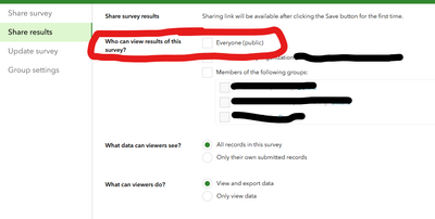

Neal_t_k
Just a shot here: who do you have the results shared with,  the form is public but did you share results?

Neal_t_k
Davide_Pili
Thank you. I had only shared the Feature Layer with Everyone, but not the view that ArcGIS Survey123 created. Now it works.
