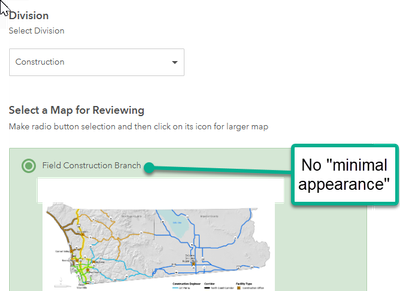

Here is what I have.  See image
Should I change the name of the labels to be different from "mapsource"?

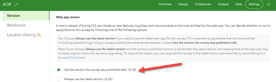

Are you getting an error message or are they just not showing?
Are you seeing this: https://community.esri.com/t5/arcgis-survey123-questions/survey-123-form-error-initializing-form-err...
if so, you can put "?version=3.21" after your url on for the webform and it may bypass the error code.
Also are you using the minimal appearance for you select_one question with the images?  If so try taking that appearance off and see what happens.
YasnaiaMassie
We are in the right path.
I did cross out "minimal appearance", and I can see the image but I can't click it to enlarge it.
And I did save to 3.18. See image.
Where exactly "?version=3.21" goes?
