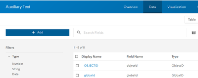

Regarding the addition of the fields, Survey123 is offering to add the additional fields to the feature service during the re-publishing (see the publishing dialog image). Our concern is that we have added new fields in the past and never received the warning "The existing feature service is not compatible with the survey". Our understanding is that this warning means that if we re-publish the survey with the changes then a new feature service will be created and the old data will be lost.

You need to add the fields from the AGOL Content page, not via S123.
I don't know if that message and overwrite option is a new addition, but I have only seen it when adding fields to the original form in Survey123 Connect.
When adding new fields to additional forms that were created using the "from existing feature service" option, I get a different error that my form cannot be published due to fields not being in the feature service.

I added the fields to the feature layer in AGOL like you recommended and re-published the survey. It worked fine without data loss.
