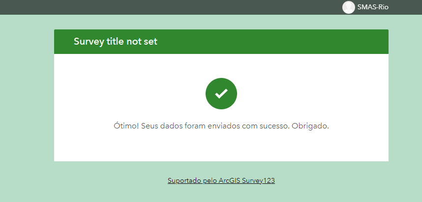

Recently, we've been experiencing some issues with the thank you screen after submitting a survey.

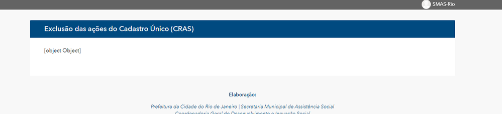

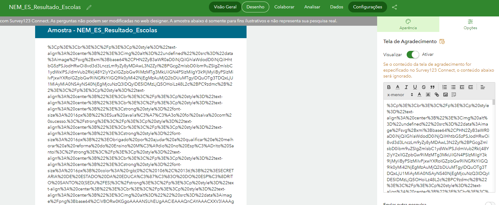

In some surveys published in pre-3.16 versions of Connect, the message was replaced with strange code. We verified this in a form that was published and running in 3.15, and in another one that was created in 3.15 and republished yesterday with 3.16.

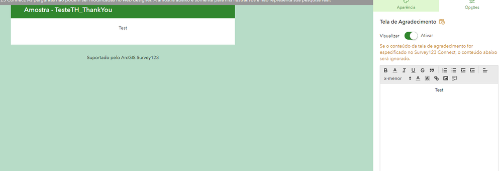

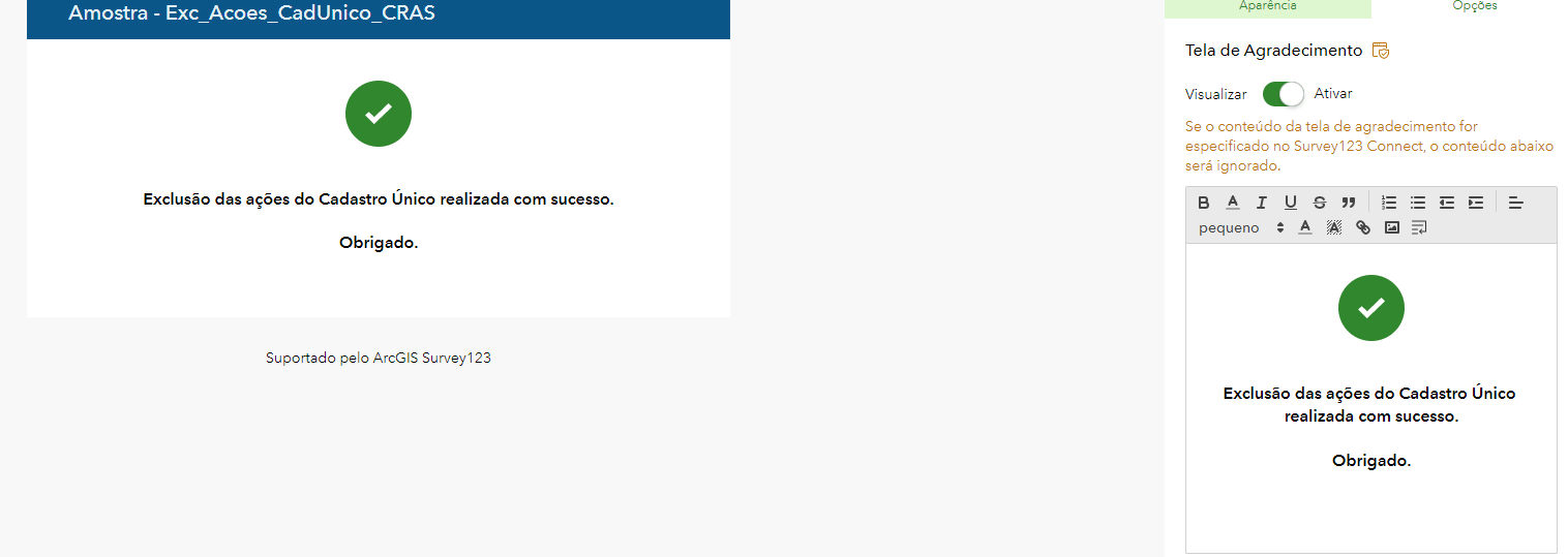

In surveys created and published in version 3.16 of Connect, we are no longer able to control the thank you message via the Survey123 website (the message edited on the website is simply ignored and a default message is always displayed).
UPDATE: In a poll republished with 3.16 yesterday, not even the default message is displayed, but another strange message.
