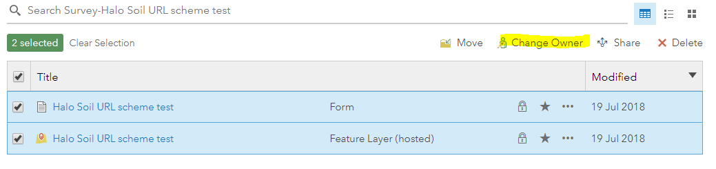

Or you can change owner of items via the Content tab and selecting the items and then Change Owner, if you are signed in as that owner, or an admin:
