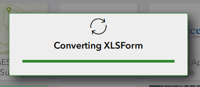

I made some adjustments to my Survey123 Connect excel file and am trying to save these changes. The document saves, but I get the following error message in Survey123 Connect:
Error Report Details
Status code: 0
Operating system: windows
Application version: 3.11.123
Framework version: 4.3.193
Does anyone know why this would be happening and how to get the changes to update?

VanessaSimps
Thanks for the quick response. However, that doesn't seem to be helping. I uninstalled and installed the newest version of the software and tried again.
I am still getting the same error message.
I also attempted to add a New Survey and import that excel file in as a new survey. But I am getting the spinning wheel of death...
I am wondering if our Sophos software is blocking this somehow?

VanessaSimps
I finally figured out what was going on... I had the incorrect REST API URL in the settings and my Survey123 Connect shortcut was somehow still opening up an older version of the application. Once I got those two things squared away, I was back in business. thanks again for the quick response out here!
