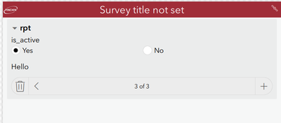

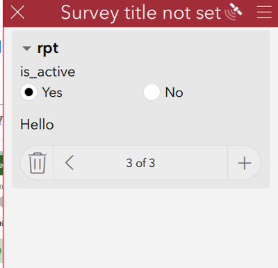

You didn't mention where this isn't working. I tested in both web and S123 Field App. Worked in both.
Is your S123 Connect (and maybe field app) up to date? I recommend using the Microsoft Store versions of both apps as those auto-update.
Connect:
Web:
Field app:
I attached my test in case you wanted to inspect.
