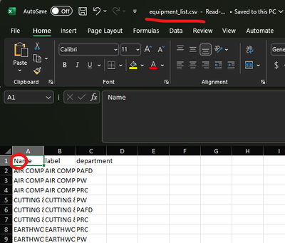

Neal_t_k
The capital "N" in Name in your equipment_list.csv is likely the culprit.
https://community.esri.com/t5/arcgis-survey123-blog/survey123-tricks-of-the-trade-choice-filters/bc-...
PhilipEnyinnaya
This actually worked. Thanks buddy
