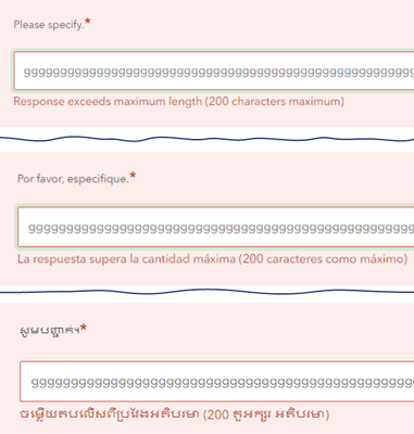

Desired output: Ideally, this would be what the user sees when they enter any number of characters past 200. Here is the result that comes from row 4 of the attached sheet in English, Spanish, and Khmer when 201-254 characters are entered in the text box:

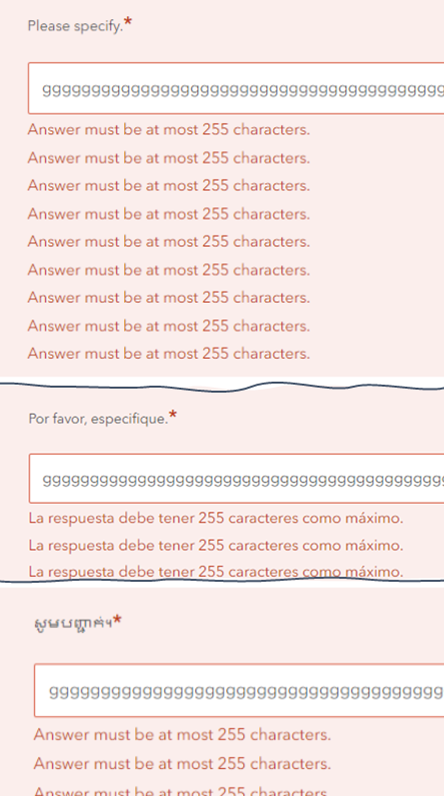

I created a constraint "string-length(.)<=255" with a custom constraint message in each language (see row 2 of attached sheet). Instead of displaying my custom constraint value, the web app now displayed the default message 9 times--once for each "constraint_message" language column. Here's that result in English, Spanish, and Khmer:
Through trial and error, I found some workarounds. The 8 duplicate messages are removed by constraining to a "less than" statement instead of "less than or equal to" (line 3 of attached sheet), but the default message still overrode my values.

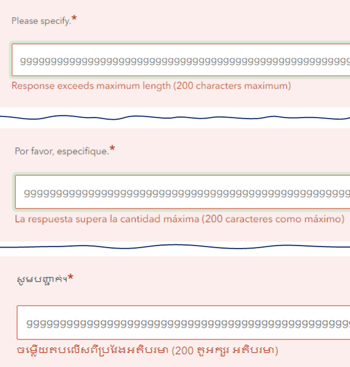

I have only been able to get around this by lowering the constraint maximum below the field length. The default message still overrides my custom messages if the user surpasses the field length, so I have set the constraint to "string-length(.)<201". A user input between 200 and 255 characters gets my constraint_message value, which gives some buffer time where they can see the message in their language before they type so much that the default overrides it again.
