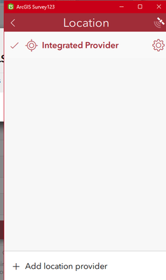

qz
Hi abureaux, Thanks for replying. Yea we did. Here you can see the Eos is connected as the provider and yet there is no location info. The app for the Eos itself shows multiple satellites in veiw but the satellite view within survey shows 0 in view and 0 in use.
