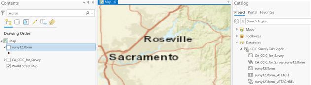

Hello @DougBrowning,
I am following your steps for creating the relationship etc, which I have done. But I do not know how to publish gdb as a service feature service. From your instructions - Publish this gdb as a service.
I have the two layers in the content and then my CCIC Survey Take 2.gdb in catalog.
How do I publish the gdb?  I googled it, but wasn't helpful.
Thank you,
Annette
DougBrowning
MVP Esteemed Contributor
First hit for me 🙂
https://pro.arcgis.com/en/pro-app/latest/help/sharing/overview/publish-a-map-service.htm
If this is your first time good luck.
