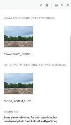

Unfortunately, it is definitely the fact that you have esriFieldTypeString in the bind::esri:fieldType column for the image question that is creating the issue. I tested with my own survey. You can see I submitted the same photo for both questions, and they both display in survey123.com

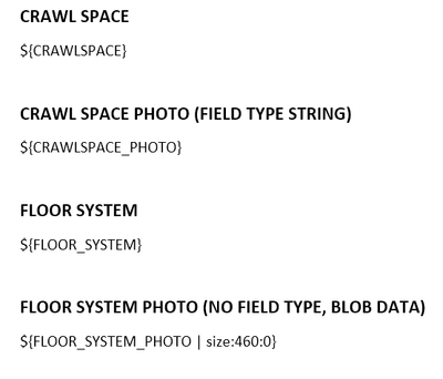

And here is the report template syntax:

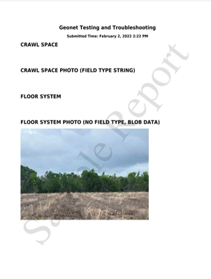

And the final report:
