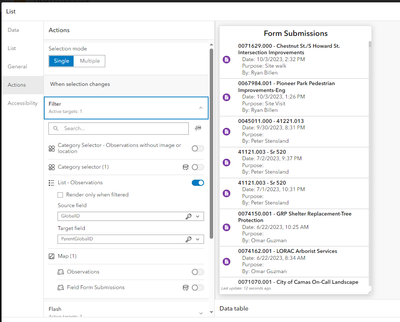

A main layer and a repeat sounds like the right approach.  That should work for generating a feature report and a dashboard.  Is the dashboard configuration the part you're struggling with?  What about something like this?
"Form Submissions" = Layer 0 (I imagine this would be information about the person/perp)
"Observations" = Layer 1 (violations)
Selecting an item in the list element for Layer 0 will filter the other list element for layer 1 to only the observations(violations) relevant to that specific record.   You can also embed the survey in another element to give you the ability to edit in the dashboard.
