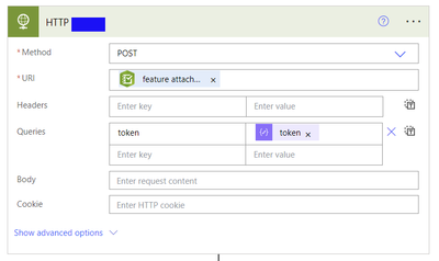

Does anyone know how to generate tokens from Survey123 using HTTP action using Power Automate?
I know that if I use the following as "body", I can generate a token without issues...but it against best practice.
username=USERNAME&password=PASSWORD&f=json&referer=https://survey123.arcgis.com/surveys?portalUrl=https://yourportal.com/portal

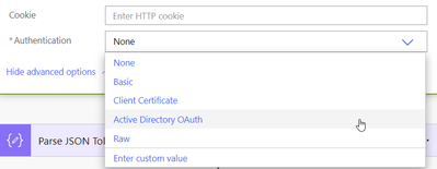

Any of the following authentication method will work? I tried "Basic", but it didn't not work...but return 400 error asking for username and password.
Are any tutorial or blog post regarding this? I need to generate "token" for public facing survey securely using Power Automate, since public facing survey will not have "token" generated for Survey123 "Create Report" action.

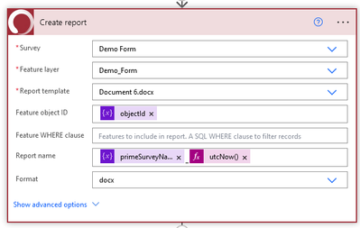

You can use the new built in action rather than custom HTTP for most operations now:
If you are using an old Custom Connector in Power Automate, then this feature isn't available to you yet. After a quick and easy update, you can make use of this new action.

Thanks a lot! I think that I actually had no problems with "Create Report" but more is for processing "attachments" from submitted survey. My automation uploads them to OneDrive, and copy it to SharePoint Online. Survey123 attachmenrs in Microsoft Power Automate (esri.com)
Any solutions for requesting token securely without exposing credential in the body of HTTP (https) reqeust?

Well, Azure Key Vault is a possible solution for obfuscating login data in Power Automate. I don't have experience with this though as we are just getting our Azure environment set up.
ArthurSmith2
We ran into this same issue and ended up generating an API key in AGOL to avoid using credentials in the flow at all or having to generate a token in Power Automate.  You can also configure the key to only have access to layers it needs, another security enhancement.
