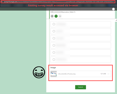

@JoelClark2 thanks for this insight. I was having a similar issue whereby I am using a referral URL for a survey published within Enterprise 10.9.1. The existing FeatureService (URL) has attachments enabled. Like your original issue I could not see these attachments when viewing records via a URL such as:
https://survey123.arcgis.com/share/9XXXXXXXXXXXXXXXXXd?portalUrl=https://myEnterpriseURL.org/portal&...
I did some testing just now following your steps. Here’s what I did:
  1. Recreated a new S123 directly from the referral FS URL, so it remade itself in the exact same format.
  2. Before publishing I removed the referral URL, so it published itself with a new hosted FS that would be the exact same schema as our existing FS.
  3. Added a new record with a photo to this new survey.
  4. Visited the URL for new record: https://survey123.arcgis.com/share/5xxxxxxxxxxxxxxxx9?mode=view&globalId=fcb58472-2585-4d3a-81f4-aab...
  5. I could edit the record and see the image.

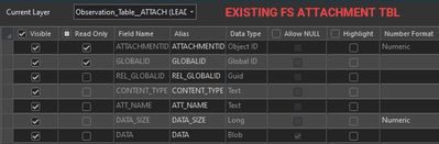

  6. Added my new FS made in #2 above to a fGDB, downloaded and compared the attachment table to our existing one. Unlike as described in this post there was initially no difference at all…
In order the get this working I had to then:
  1. Use the 'Upgrade Attachments' GP tool within Pro on the FeatureClass (not the attachment table but the main FeatureClass) to add the KEYWORD and EXIF fields.
  2. For those existing records I calc'd the KEYWORD to be the name of the S123 question
  3. I then also set the DEFAULT value for KEYWORD to also be the same name of the S123 question. This didn't work for some reason.
  4. Instead I set up an attribute rule to do the same thing. This works.
  5. Republished.
Now I can see images on the end of URLs!

Option 1. You can export and download the feature service item as a File GDB. Make the edits (this must be done in ArcGIS Pro) to the downloaded attachments table KEYWORDS field...
I have exported my AGOL-hosted Survey123 FGB, and in the attachments table there are no KEYWORDS and EXIFINFO fields as shown in your screenshot.  Where did they come from?   My survey is 12 months old, is this from a newer release of Surevy123, or is it a Portal-only thing?
