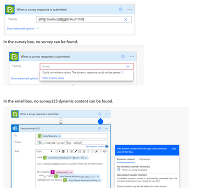

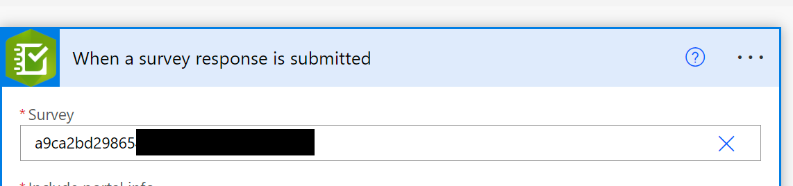

I am wondering if those who have been using Survey123 + Power Automate with your ArcGIS Enterprise environment have similar struggles like me.

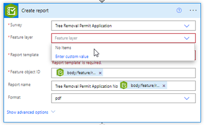

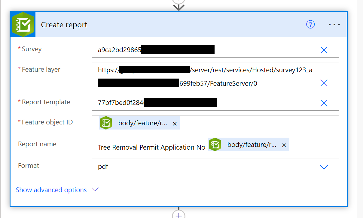

I can't seem to get any sweet auto populated dropdown options when use "When a survey response is submitted" trigger and "Create Report" action. Especially "Create Report", I have to find their unique "ids" to make it work. It's now somehow not working, but that can be story for another day. I was incredibly happy to know where to find them, and was able to generate PDF S123 report 🙂
Sweet dropdown do show up sometimes for "Survey" option, but other fields needed for "Create Report" has never shown up for me.
Is this something to do with IT configuration of the ArcGIS Enterprise?

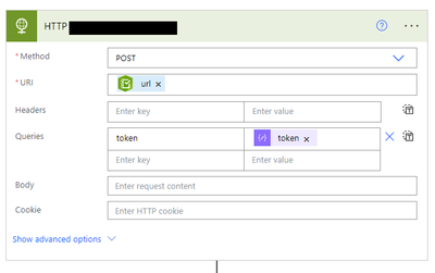

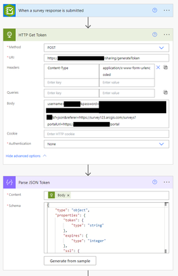

It's not ideal to have credential exposed in Power Automate, but this method above allows me to use HTTP action to generate secure token using user's credential who is able to access attachments!
Then, use the token to access attachments 🙂

Typically, I see the raw survey ID when the Survey123 Connector times out. This happens every 3-4 weeks.

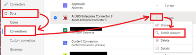

Go to Data > Connections > Find your connector and click on the ellipses (...) > click Switch Account > log in
Then, go back to your flow and you should see a list of items again. If that doesn't fix it, then there may be something wrong with your Custom Connector.
Edit: Btw, I didn't think that the new Create Report module worked with Enterprise? I assumed that was for AGO only. That may be part of your issue. But my comment stands for the Trigger. (I may stand corrected?).
Edit2: It occurs to me that, unless you customized your Custom Connector (which is possible), you are likely also using the AGO Trigger as well. It seems you asked a similar question here. If you are using Enterprise, as you indicated, you will need a Custom Connector. Here is a guide to create the Custom Connector and a report.

Hello, I experience similar time-out in my project. The dynamic content won't show up.
Sign-in again to my custom connector sometimes fixed my flow. What also worked for me is to add a new connection in the flow itself.
Or make a new flow if it's not too time consuming.

Actually Create Report trigger work for enterprise 🙂 you just need to update the custom connector. However, when I first created the survey...everything seemed to be working. However, once I start configuring the survey and publish it and made it bit more complicated...things start not going according to the plan.
For example, I cannot get the "Feature Layer" auto-populated even when the survey dropdown is working.
or Report template to show up
I did not use the AGO trigger, but trigger for ArcGIS Enterprise (portal) [You need to make a custom connectors]

Hi everyone, I stumbled across this post looking for something else but I had a comment about another way to do this that doesn't require any password sharing.
For clarification I believe what the original post was referring to was utilizing a survey/report they have access to but are not the owner of.  It still will require 2 accounts, but the key thing is to make the owner of the Survey (in Enterprise) the same as the credentials used in the PowerAutomate connector.
Within your enterprise first create a shared collaboration group.  The users with access to this group should be the original creator of the survey/report and the account used to connect in PowerAutomate.  Once the survey is built and ready to deploy allow that group to Update the Survey (under the Collaborate tab), then change the ownership of all survey items to the account who manages the PowerAutomate connection.
This will allow the original creator to still make changes as needed to the survey, and it will allow the PowerAutomate Connection to see the survey and reports by their name rather than the item number.
