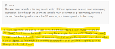

@FlaynerRessoni  You mentioned in your first post that the certain users "belong" to a front.  Can you add a field in your form that assigns a username list when a  front is selected.   If so, you use the inbox query to only return surveys assigned to that user.
https://doc.arcgis.com/en/survey123/desktop/create-surveys/prepareforediting.htm
FlaynerRessoni
Thanks for the suggestion. Unfortunately this approach won’t work for our scenario.
The same user may need access to all fronts, depending on the activity, so we cannot filter the Inbox based on username.
