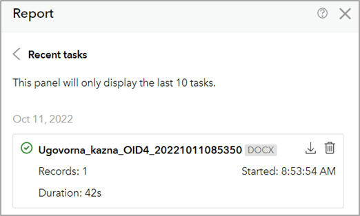

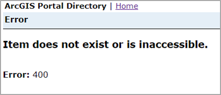

After selecting an object, and clicking on Generate, a report filled with data should be generated, but instead, I recieve an error: “Item does not exist or is inaccessible” (Error: 400). Error is received automatically when the report is “created” and when clicking on the download button.
There IS a green check next to the task, which makes me thing the report IS created, but cannot be accessed.

Any ideas why I can not access the report?

What worked for me was unchecking the "Save to my ArcGIS account" button, because in my case every report had to be downloaded locally anyway.
AmyMcCarthy
That worked!!  Thank you!
