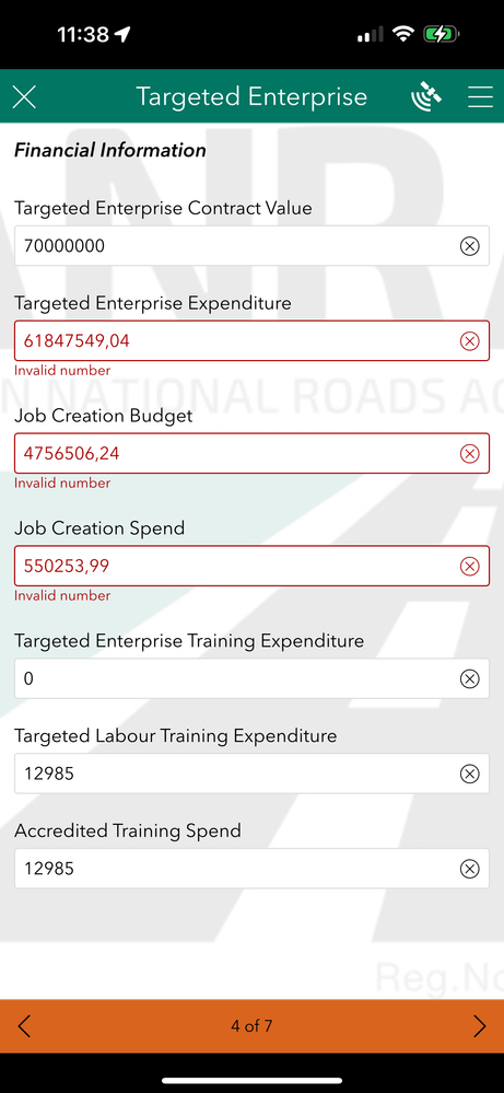

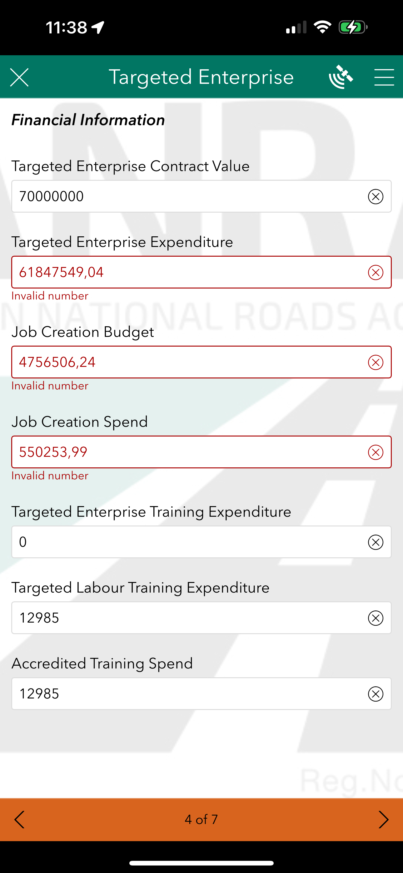

We designed a form which has worked fine up to this point. The issue occurs with decimal numbers only. A user is facing this issue in the screenshot below only when using an IOS device.
We have tested the form on Android and HarmonyOS devices and works as it should.

I don't have a solution off-hand, but I notice you are using a comma in place of a decimal. Out of curiosity, have you tried swapping to a decimal number to see if that works? If it does, then the issue should be brought up with Esri as a bug. If that doesn't work, you will need to provide your XLSX* so we can have a look at what is going on.

The standard used around here is a comma for a decimal point. Although, we did try to use the point (.) When we use it instead the entry for that field is returned empty.
Please see the XLSX*

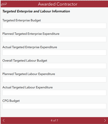

Are you sure that is the correct XLSX? I cannot find any of the fields referenced above. For example, this is what I see on page 4:
MlondiNdlovu1
It's not the one from the screenshot. But the same issue (all esriFieldTypeDouble fields) has been reported by IOS device users on this form as well. I couldn't share the other one publicly.
