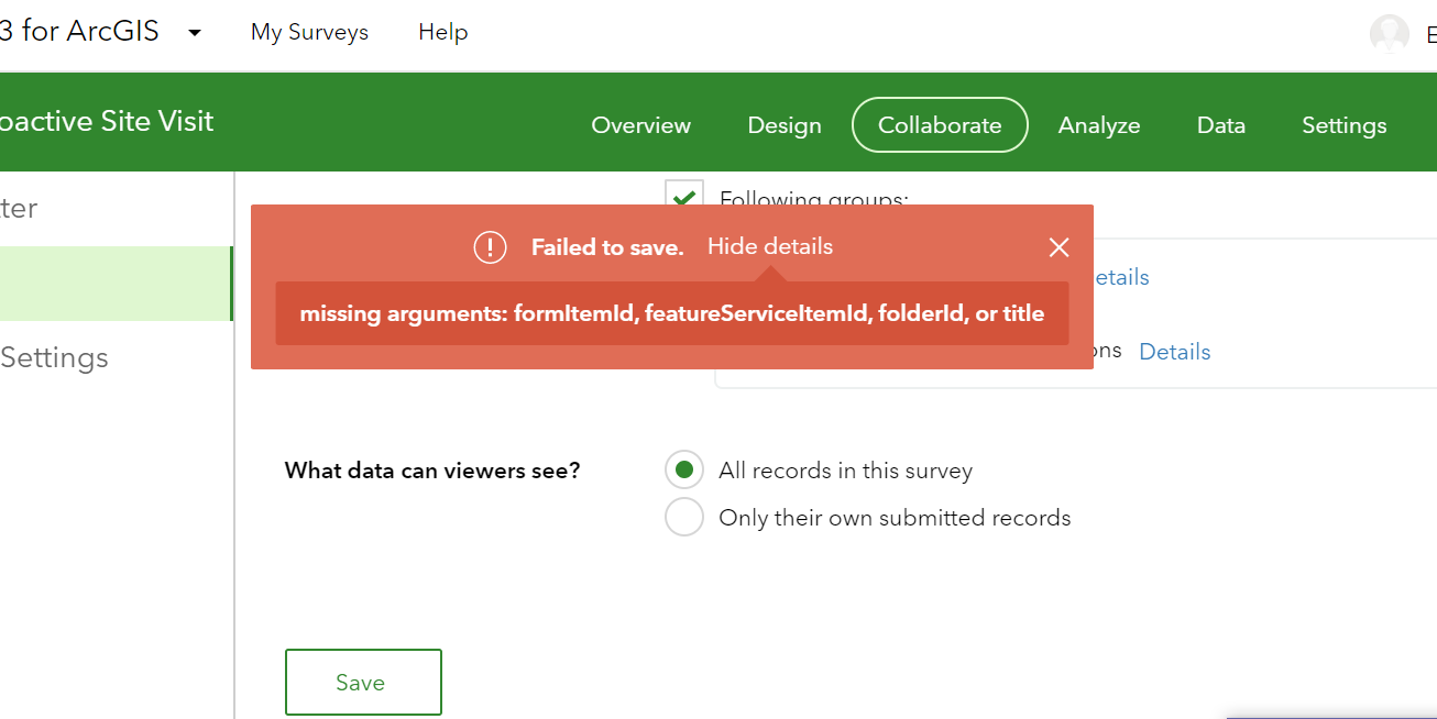

LiamWhite
Hi Brandon,
I deleted the view but when attempting to reshare in Survey123 i am getting the following message:
Does this mean i need to clear cache? and if so, is this all cache or just for a specified time period?
Thanks
JamesTedrick
Esri Esteemed Contributor
Hi Liam,
Given the age of this thread, it is likely a different error than what was originally asked here.  Could I ask you to file a technical support case with Esri Support?
