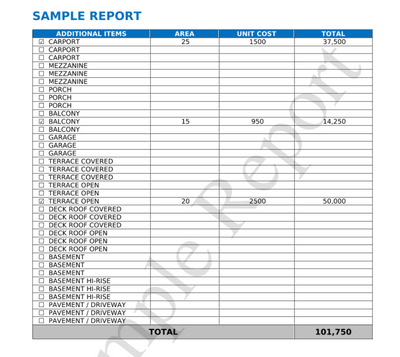

I have here a sample form (Sample Building Form.xlsx) with a repeat group. I am trying to generate a report using the attached feature report template (Sample Report Template.docx). However, the output looks like this (please see screenshot below). I have attached the same generated output PDF as well (Sample Generated Report.pdf).

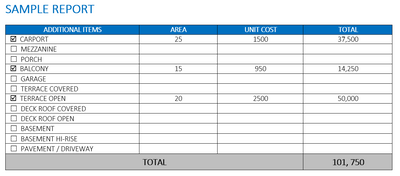

I noticed that each item in the "Additional Items" column were printed thrice. I only wanted to print every item in the "Additional Items" column, whether they have entries or none, only once (Carport, Mezzanine, Porch, etc). I prefer to have an output something like this. (Please see screenshot below)
Do you have any suggestions on how to come up with this output? I did a couple of tests, but I couldn't figure it out how to revise my feature report template. Am I missing something out?
