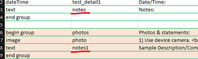

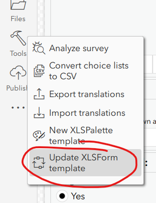

Neal_t_k
I was able to publish your form with a couple edits,  I updated the XLSForm template. You had a duplicate field "notes" and I fixed some reserved word errors.  Try cleaning those up and see if it helps on your end.

abureaux
MVP Frequent Contributor

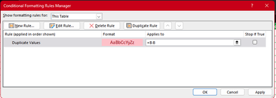

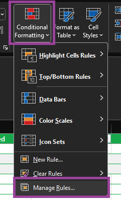

Copy-pasting and dragging content breaks the form logic used to warn you when there are duplicate field names. If you didn't know, you can repair this formula quite easily:
Click "Conditional Formatting" > then "Manage Rules..."
Delete all but one of the rules > change "Applies to" to be "=B:B" > press "OK"
Duplicate fields will be highlighted again.
Also, marking @Neal_t_k response as the answer since it helped OP resolved the issue.
