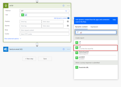

  3. HTTP (this is used to obtain the attachment and the critical part of our flow)
  4. Send an email

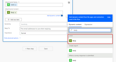

For the HTTP setup, you will need to use the GET method with url for the attachment (in the screenshot). Then you will need to use the body of the HTTP request as the attachment for email/file upload/etc...

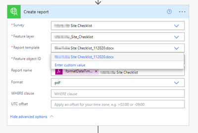

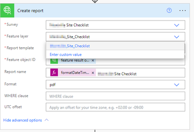

I can't think of a way to get the attachment without the HTTP GET method so that will be necessary. That being said, is the ArcGIS Enterprise account that you are signed in with for this connector the same one that owns the survey? When you select the name of the survey it should automatically populate the dropdown for possible feature layer name options instead of you having to put it in yourself. That should also be the same for the report template:
