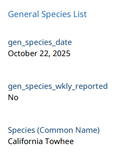

Sample individual report template (Generated by S123 website)
Resulting feature report PDF shows 10/22/2025 and NOT 10/23/2025 like it should.

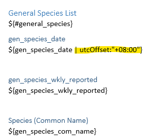

The fix! Just add utcOffset to the feature report, like so:
The resulting PDF now prints 10/23/2025 like it should.
