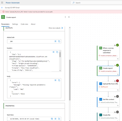

I'm in search of suggestions or ideas one why this problem keeps happening.  I thought I had the workaround for it, but apparently it is not.  Here is the error I keep seeing when the create report is triggered.  It is random and has no rhyme or reason.
Create report will show:
The problem isn't the upload file from URL, it is the create report step.  It doesn't generate the report due to the missing token and causes the Upload file from URL to fail since there is no file to upload.  When I pull up the raw output, this is what it says:
    "statusCode"200,
    "headers": {
        "Vary""Origin,Accept-Encoding",
        "X-Frame-Options""SAMEORIGIN",
        "Strict-Transport-Security""max-age=63072000; includeSubdomains; preload",
        "X-Cache""Miss from cloudfront",
        "X-Amz-Cf-Pop""DFW56-P1",
        "X-Amz-Cf-Id""Jo1GzdsXyLwoO__lWIXWWj6MlMyvx2EYcpgs0R0Vgxo0gi8Ufi4tLg==",
        "Timing-Allow-Origin""*",
        "x-ms-apihub-cached-response""false",
        "x-ms-apihub-obo""false",
        "Date""Mon, 17 Apr 2023 21:55:22 GMT",
        "ETag""W/\"5b-Mp2PQ3TXpicAGnrU8UOXH5yC4vQ\"",
        "Via""1.1 2685f5b632da4ffa2ee376ec1418d378.cloudfront.net (CloudFront)",
        "Content-Length""91",
        "Content-Type""application/json"
    "body": {
        "error": {
            "message""Missing required parameters: \"token\"",
            "code""001"
        "success"false
I originally thought it was because of my organization's login credentials expiring and that I needed to refresh my connections every week.  This seemed to have worked for a few weeks, but started happening again.  So that theory went out the window.  Please help.  Thank you.

I had the same problem. The 'Create report' did not fail in the flow but it effectively was the point of failure because an error code was output and no report url was able to be transferred to the 'Upload file from URL' action. @BarbaraWebster1  I saw that you provided the solution to a related issue. Can you help here?
Background: I setup a flow to send an email with the survey report about 2 weeks before the first submission. After multiple tests the flow was configured to provided the intended result.
Issue: That first submission resulted in a failure (image below). An error code was output indicating a token was missing. No report was generated so no url was passed to the next flow action.
Workaround: I had to delete the Survey123 Connection used in the flow in the flow management page, add a new connection, then link to the new connection in the flow editor page.
Seeking a resolution: It seems as though something in the Esri/Microsoft authentication interface changed from when I setup the flow that caused the failure. The stakeholders that I set up the survey for need to be notified of the submission. So reliability on the connection and flow is important for us to continue using this ArcGIS functionality. Can I be notified of a faulty connection so I can reset it prior to receiving a failed flow email?
