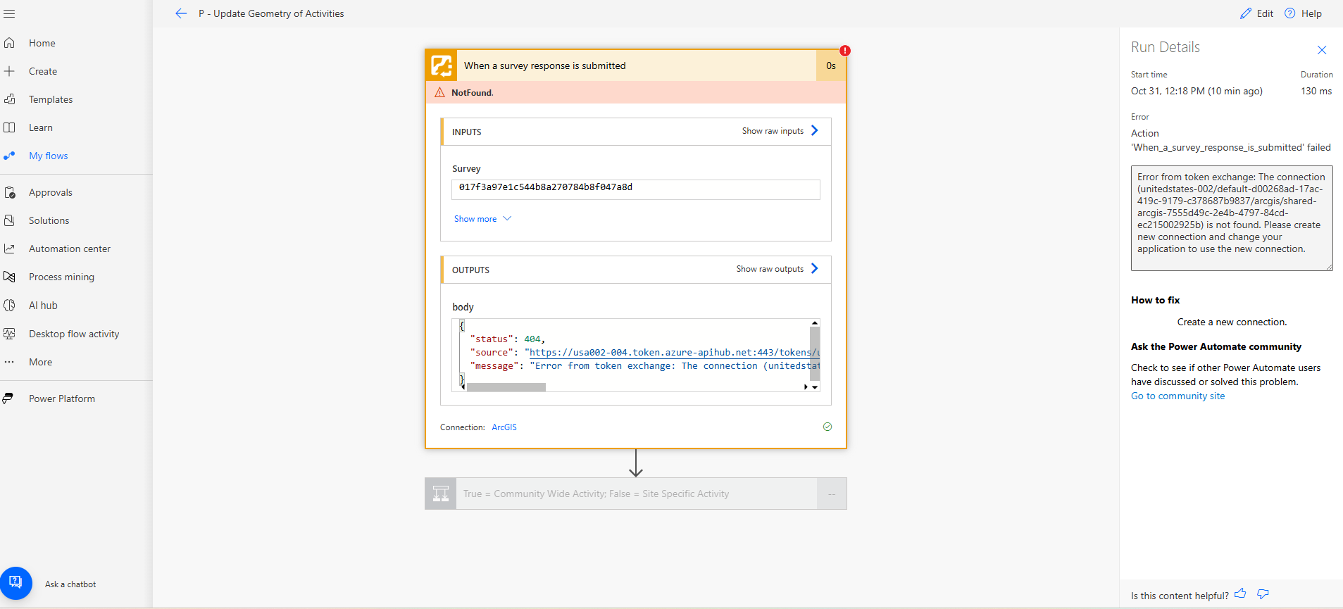

We are not seeing new submissions to S123 triggering our Power Automate Flows.  Everything in the flow looks fine - connection is valid and show list of surveys, it saves ok, and we see a webhook in the survey123 website.  In the run history, we do not see the failed runs, but Power Automate indicates there is an error, and gives us this message:
Anyone else seeing this issue?

The error message indicates a problem with the token.  How intermittent are submissions.  It appears tokens are valid for 14 days

I'm getting this after creating brand new connections on brand new flows.  And within the flow everything looks normal and it saves fine.  So, I don't think that is the issue.  I'm wondering if there is an issue with the authentication service, webhook url, or something like that.
