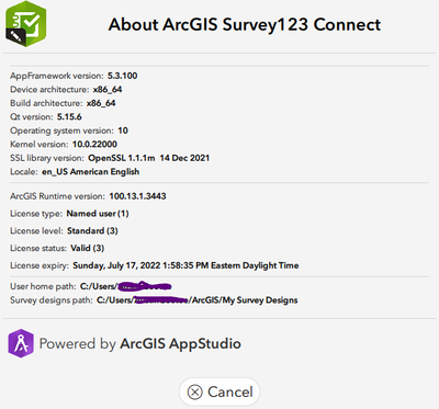

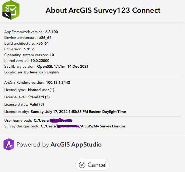

Anyone know if there's a way to change the root save folder for the surveys and their associated files in Survey123 connect. Right now it looks like it saves to the local harddrive at a path such as
C:\Users\username\ArcGIS\
where the designs would be saved at C:\Users\username\arcgis\my survey designs . I'd like to change the root folder the survey123 connect app points at to a location on our company's server. Definitely can see the paths in the about section, but doesn't have an edit or change button, any ideas on how to accomplish this?

It is not currently possible to change the directory of the My Surveys and My Survey Designs folders. We have an issue in our backlog to support this in the future. We have a few different enhancements requesting this functionality (ENH-000101301/ENH-000101302/ENH-000105975/ENH-000132527) feel free to reach out to Esri Technical Support and they will be able to assist with getting you attached to an Enhancement so you can track it's progress.
