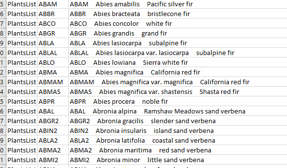

The way I do it is have the code, scientific name, and friendly name with spaces in the label column then the name column is just the code.  This way they can search for any of these they know.  If you set the appearance to auto complete they can do type ahead to reduce the list as you want.
I strongly suggest you put these in a repeat and use select one to add one species at a time.  It will seem slower at first but Using select multiple stores the data in a comma separated list which makes it very difficult to use the data going forward.

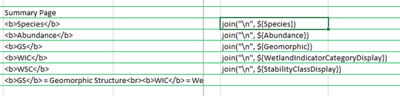

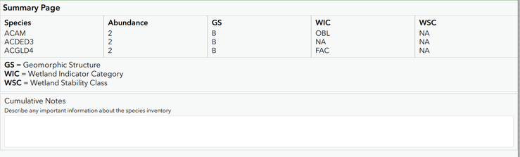

For the summary page I just use join with \n and a grid appearance and since the repeats are always in order it just all lines up for you like magic.
Other way to do summaries is inside your repeat add a calc of concat(Field1, "  ", Field2, "  ", etc) then on your summary page do a join \n with that concat field.
