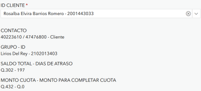

Hi @Leon_AndresSabbagh_Santos,
I replied to your private message, but just incase you didn't see it, here is what I found:
I had a look at your csv files and found a few issues. The csv file IDCLIENTE11 is using a semi-colon as separator, not commas, note this will not work, only commas are supported. If you do a find and replace of semi-colon to comma (provided you have no semi-colon in the actual data) this will start working properly.
Also, in the select_one_from_file csv file, you have a name column with numbers, and then the label, but in your original choice lists in the choices sheet, the name values were the same as the label. Seems to be a change here. You can remove the numbers and just make the name and label columns the same, you only need two columns in this csv file.
Also, once you move to select_one_from_file, you need to remove the same choice list from the choices sheet.
Once I changed the commas and fixed up the name and labels to all be the same, both the select one choice list and pulldata expressions all work as expected. Also the lists and form preview loaded fairly quickly for me. See screenshot and attached files.
As for the publishing errors, I did not get any errors when publishing to AGO, it could be the name of a layer or symbol or character you are using in the spreadsheet or choice list that is not supported in feature service definition and the hosting database.
Regards,
Phil.
