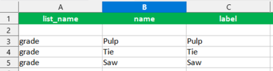

You can use a calculation with a few nested "if" statements for this.  Assuming you're tracking DBH as integers, and your select list looks like this:
You could have a "select_one grade" question with this calculation on it:
