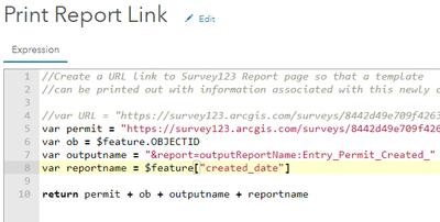

Following studebakers_Boulder's "idea" link took me to the solution for this. I was able to build out my URL and name my report with unique data from the point by using an Attribute Expression.
outputReportname: is the function to do so
An example of what I created is below:
This links me to a report page via a URL in the point pop-up, automatically selects the point who's URL I followed, and names the report after the creation date of the point.
